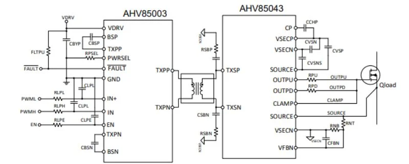

The AHV85003 and AHV85043 join Allegro’s Power-Thru family of isolated gate drivers, complementing the existing AHV85311 integrated solution. Power-Thru technology allows both the control signal and gate-drive power to pass across a single isolation barrier. This design can eliminate the need for separate isolated bias supplies or bootstrap circuits.
Using a single isolation path helps lower common-mode capacitance, which limits switching noise and supports improved electromagnetic compatibility. Less noise at the driver stage may reduce the need for extra filtering or complex board layouts. Both chipset and integrated solutions support adjustable gate drive voltages and negative turn-off to suit different SiC devices.
Typical Application of AHV85003/AHV85043
