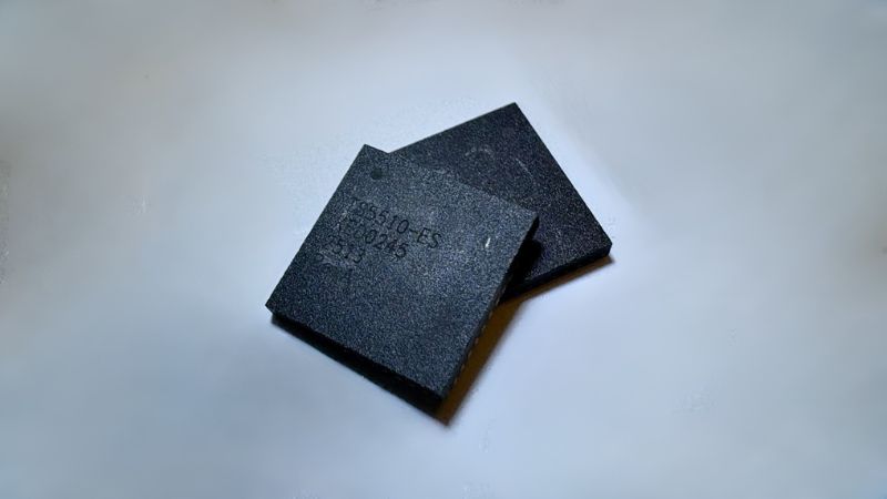

Triad Semiconductor Unveils the TS5510 Audio Capture Chip
Triad Semiconductor has launched the TS5510, a dual-channel analog front-end (AFE) low-noise programmable-gain amplifier for audio recording. The device suits both home and professional setups, delivering unmatched input flexibility.

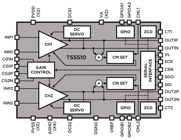

Current Conveyor Architecture
Using current conveyor technology, the TS5510 achieves lower delay, higher dynamic range, reduced power consumption, and minimized switching noise. Digital control allows both inputs to accommodate varying signal levels without external components.
TS5510 block diagram

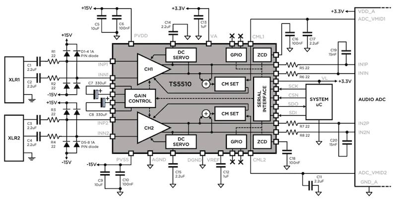

Typical application diagram
Applications and Availability

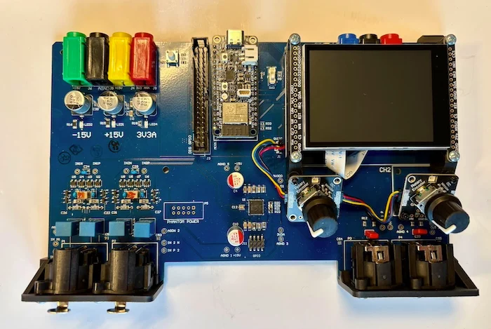

The TS5510 simplifies audio mixers, USB audio interfaces, stage boxes, and routers. Triad offers the TS5510 EVK evaluation board along with sample schematics and PCB layout. Production deliveries are scheduled for March 2026.
